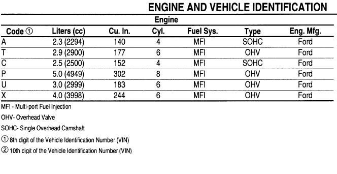

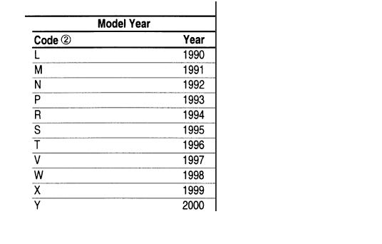

twoj VIN to:
EX II 1996 4.0 efi VIN 1FMDU34 X 0TUC23257
istotna jest 8 i 10 pozycja VIN'u
8 = X czyli OHV
10 = T czyli 1996
co do ASB to:
1991–94 code T is for the A4LD transmission
1995–99 code T is for the 4R44E (2.3L, 2.5L & 3.0L) or 4R55E (4.0L) transmission
1996–99 code U is for the 4R70W (5.0L) transmission
1997–99 code D is for the 5R55E (5-speed automatic) transmission
