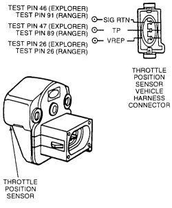

Using a Digital Volt-Ohmmeter (DVOM) set on ohmmeter function, probe the terminals, which correspond to the Brown/White and the Gray/White connector wires, on the TP sensor. Do not measure the wiring harness connector terminals, rather the terminals on the sensor itself.
Slowly rotate the throttle shaft and monitor the ohmmeter for a continuous, steady change in resistance. Any sudden jumps, or irregularities (such as jumping back and forth) in resistance indicates a malfunctioning sensor.

Detach the wiring harness connector from the PCM (located behind the lower right-hand kick panel in the passengers' compartment), then install a break-out box between the wiring harness connector and the PCM connector.
Turn the ignition switch ON and using the DVOM on voltmeter function, measure the voltage between terminals 89 and 90 of the breakout box. The specification is 0.9 volts.
If the voltage is outside the standard value or if it does not change smoothly, inspect the circuit wiring and/or replace the TP sensor.
Fig. 2: TP sensor wire harness connections
